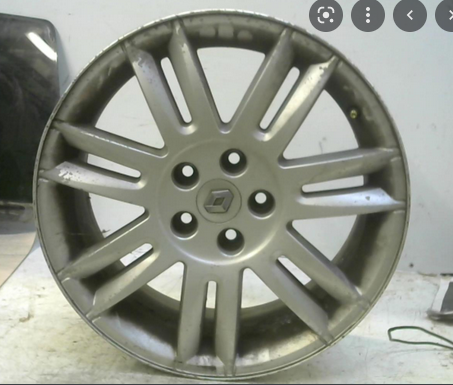

gege08 a écrit : 27 août 2022, 12:06 Capture.PNG
juste pour ma curiosité, ce sont les mêmes que celle ci, quel est son nom? (photo du net)
apparemment, ce sont bien des jantes d'espace 4 ph1
These rims are called Monterey and were standard on the Espace IV Phase 4 Initiale and also in on the Vel Satis Phase 1. Now I use them for my wintertyres, normally i've got 18" Aria's fitted under my Espace.
When switching between 17" (225/55R17) and 18" (245/45R18) the dealer didn't make any changes regarding the ESP. It only looks at the different rotation speed between tires, the steering angle and measurements from the G-sensor. Wheel size has nothing to do with the ESP. It also automatically detects the different pressure sensors. You can program two different sets.
Sorry for writing in English, I'm from the Netherlands and we don't have an Espace forum ;)
Just click translate in Google and everything will be ok :)

merci pour ces infos
